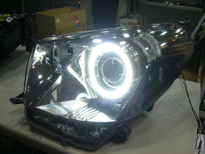

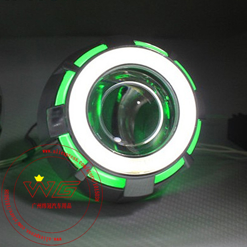

Hi has anyone dissasembly the headlight of an iq ? i want to do this (first experimentaly ) and the pro :) to try to fit an angel eyes kit to my car . something like in the pictures below....isaw in other forus that someone is selling the about 350 gbp , but i prefer to do it my self

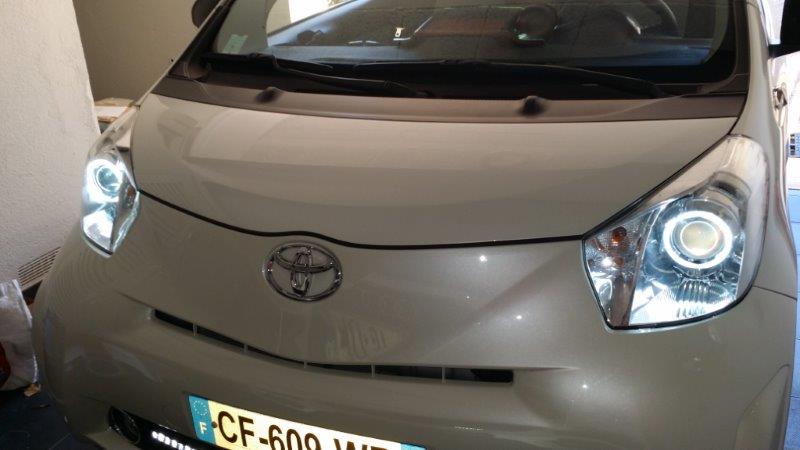

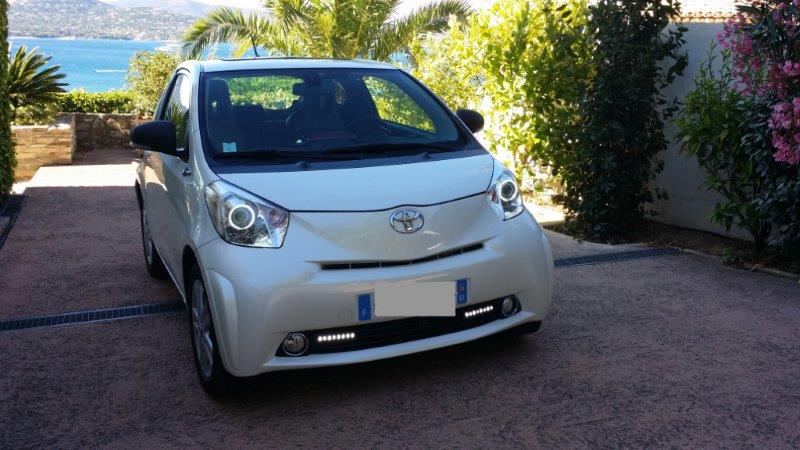

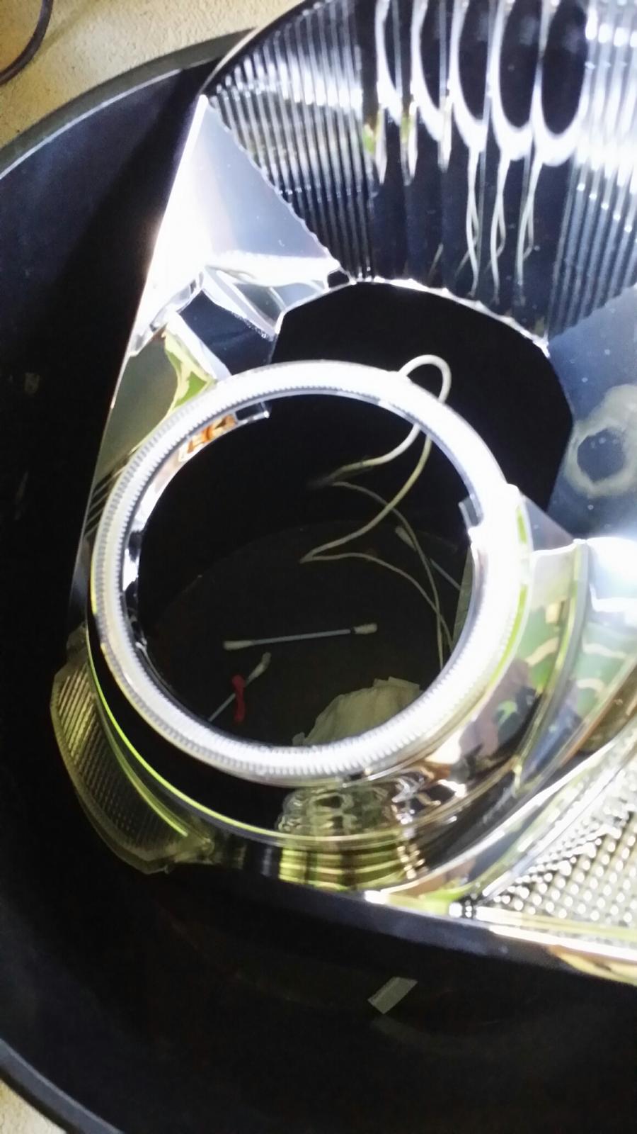

Soon pictures with the headlight with Onion rings....................on the car

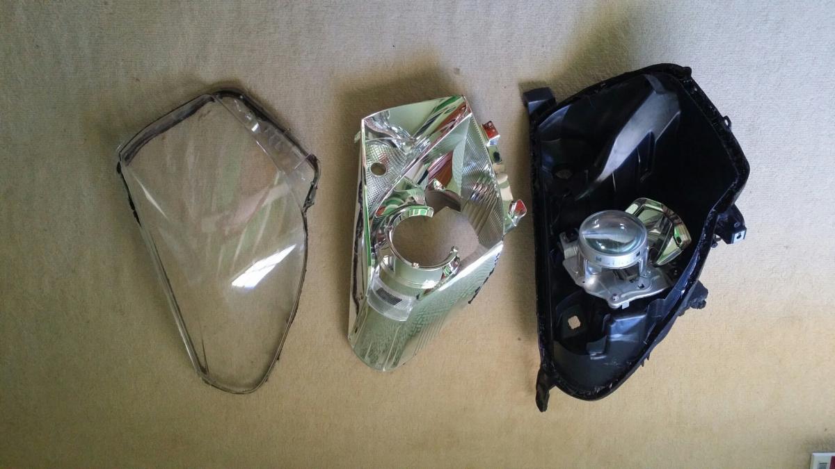

Can you describe how you disassembled the lamp please

Happy David to see that you are enthousiast.
To order to Ali....., the problem is that if you buy 2 rings, they will sell you only 1 inverter. And to fit on the car, you need 2 inverter. So the cheapest way is to order 2 pairs of rings with 4 inverters, and to find a friend who want a pair.
The link of the Angel eyes is
http://www.aliexpress.com/snapshot/6133000393.html (you can mail to Cathy, very nice)
You must order 2x2 105mm white angel eyes with 2 inverter, and 2 supplementary inverter.

Do not forget a pair of gloves to works on the headlights at 80° after the oven episode, and a pair of white soft gloves to work on the headlight when it is open...very important)
A little works.....for the holidays

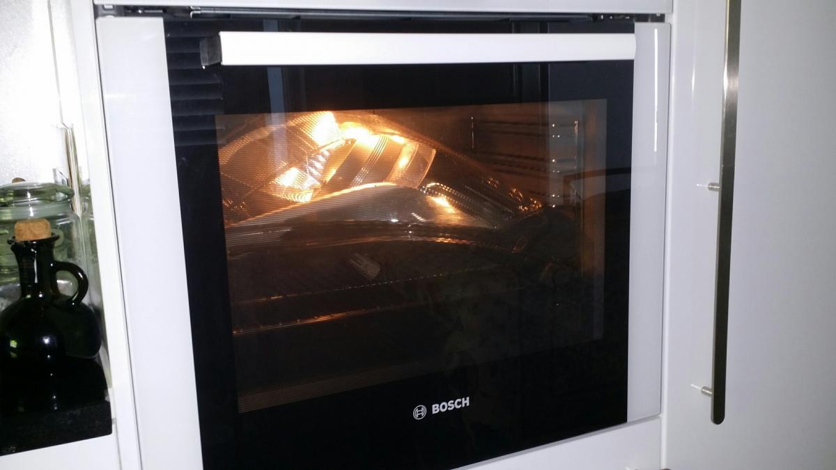

Quick at the kitchen....................

What is the procedure with the oven. What do you have to do

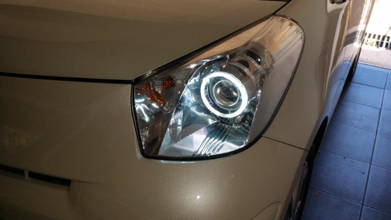

Why do i need 2 inverters. The bottom picture shows one inverter supplying 2 rings i can extend the high voltage wires and the inverter can be powered from my existing DRL module which does what you described

David you cannot cut or make longer the joining between the angel and the inverter. You must use like it is (around 40cm) so it is impossible (to short) to plug the 2 rings on only one inverter.
About the procedure, you have a lot of tuto describing how to open the headlight, with a hair dryer or with a heat gun or with an oven. The best is the oven during 15 minutes at 80°. After it is easy to open it.
Take of all what is possible, All the metalic screw.
If you need some more informations ask me. When you will be ready to do it, tell me I will call you before.
One important think, is to wear white soft gloves for all the operation inside the beam.
