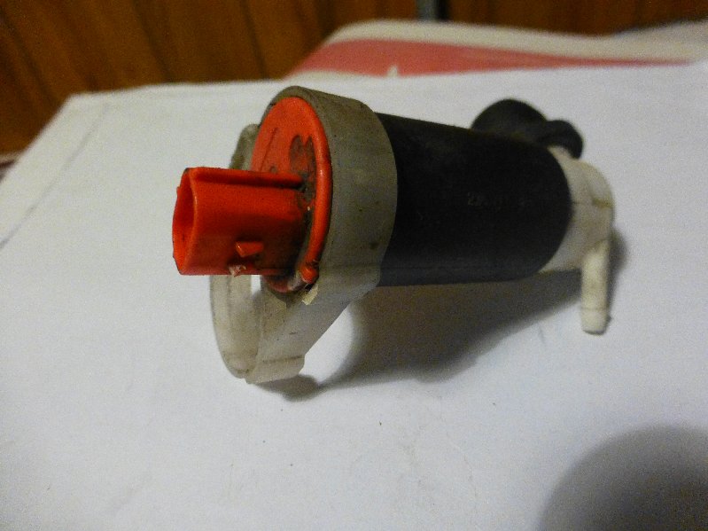

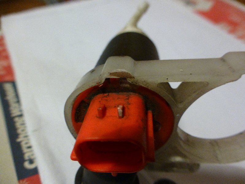

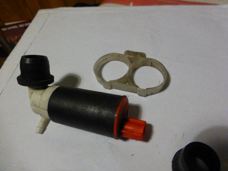

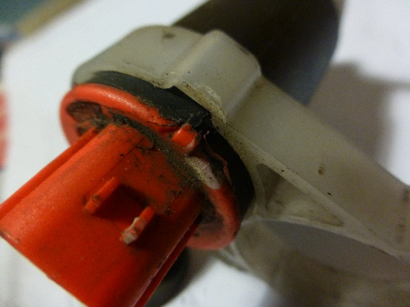

Once you have made access to the reservoir, unplug the pumps then push the collar that supports the pumps up with a screwdriver, then pull the pumps away. Then slide the faulty pump down and align the notch with the hump in the collar to release.
I got a set when I need to change one of my pumps. I still have my second pump in case the other fails.
post-76861-0-32014600-1418493815_thumb.j the remaining pump in the retaining collar
post-76861-0-63147400-1418494260_thumb.j aligning the notch to remove the collar.
post-76861-0-58569800-1418494284_thumb.j just before collar removal.
post-76861-0-69211400-1418493840_thumb.j the pump removed from the retaining collar
