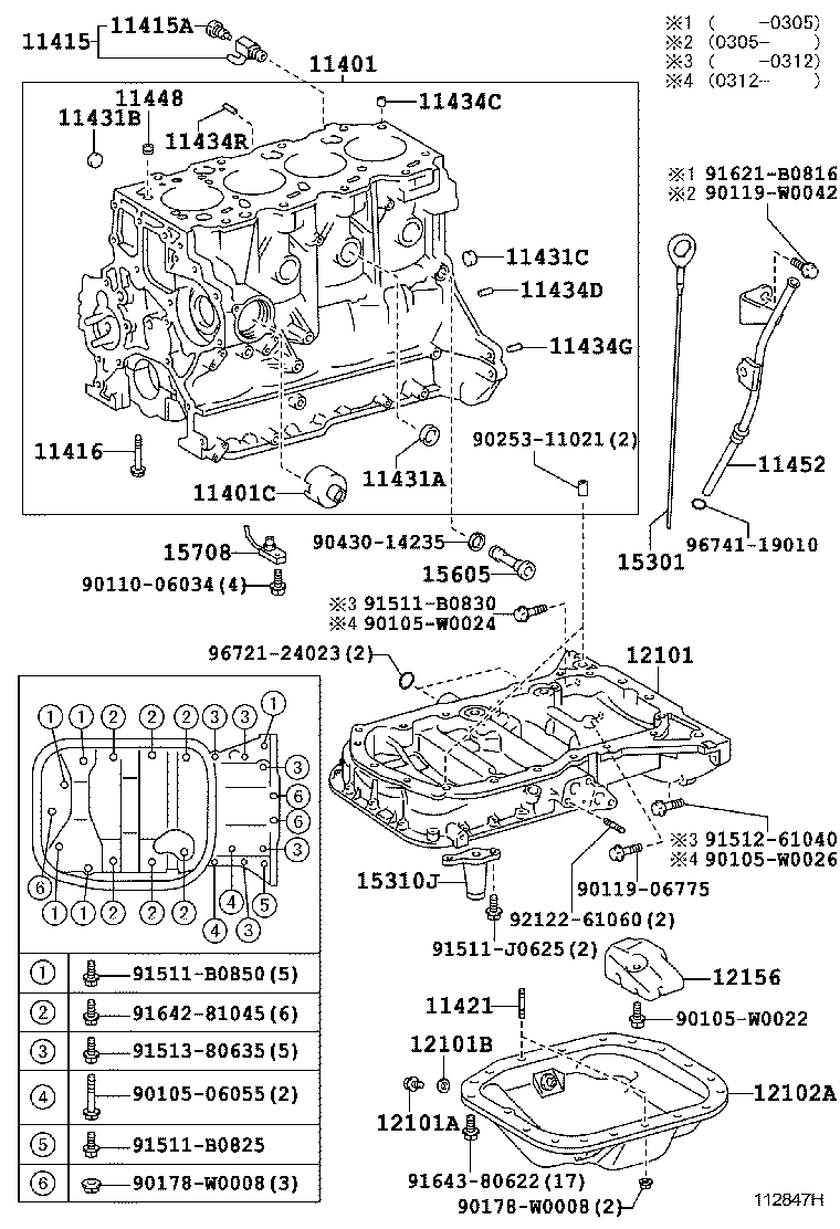

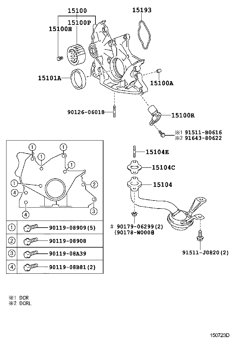

The more i trawled the net the more i read about blocked oil strainers, the one i just read, said or suggested that a lot of the turbo problems on the d4d could actually be attributed to poor oil flow from strainer,which would mean that a lot of turbo replacements might be short lived, i would be interested to know how easy it is to remove sump and look at strainer as it seems to be a a way to avoid a few problems or eliminate them.
looking at these pics attached it seems straight forward.
