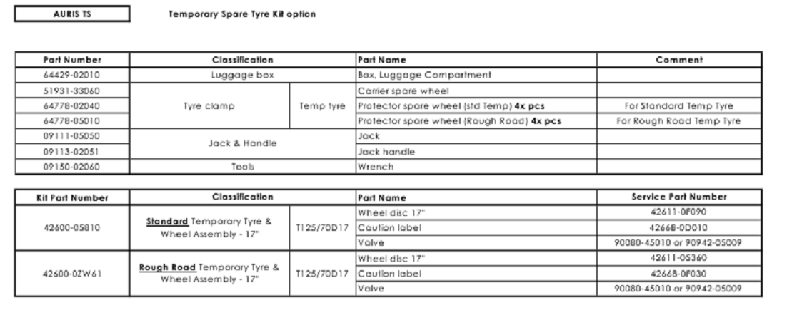

Attached is a list of part numbers required to fit a spare in an Auris TS, If your wheel retaining bolt is too long I would say it is wrong go back to your supplier.
post-45863-0-05051800-1425410269_thumb.p
