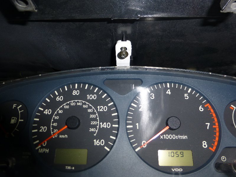

There are a couple of connectors behind the instrument panel that have latches to secure cables. Check to see if they are locked in place.
To access the back of the instrument you need to remove the instrument panel itself.
First lower the steering column.

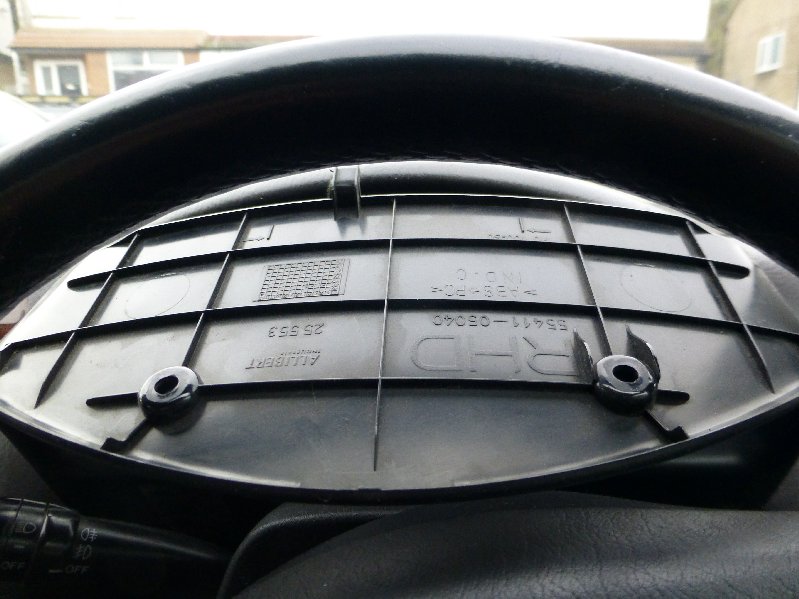

Next remove 2 screws from the instrument surround post-76861-0-31127200-1429085467_thumb.j then remove the surround by pulling towards the steering wheel post-76861-0-29065600-1429086065_thumb.j.

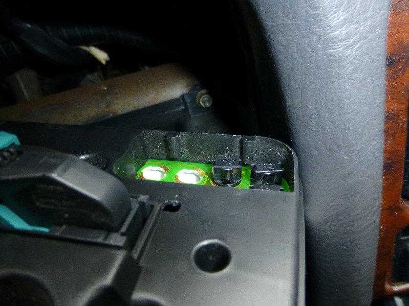

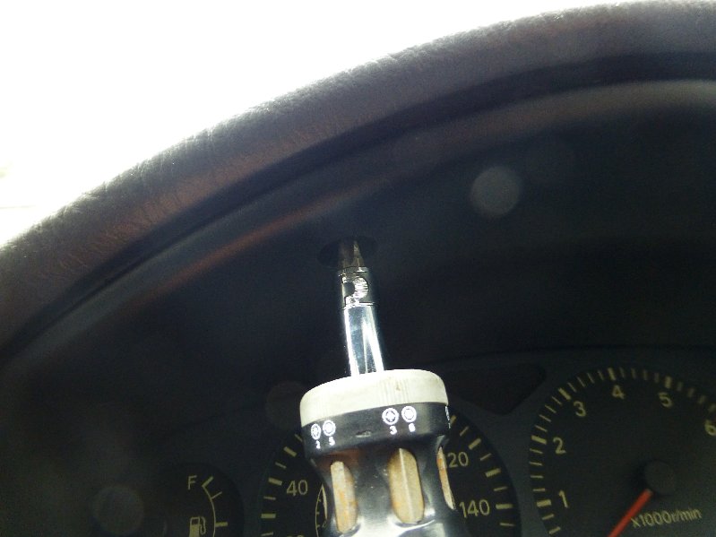

Then remove 3 screws to release the instrument panel post-76861-0-87043600-1429085708_thumb.j one at the top, two at the bottom. post-76861-0-31846900-1429085916_thumb.j

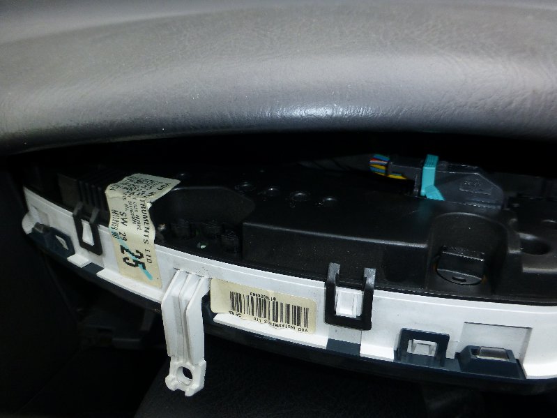

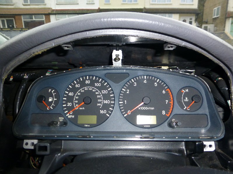

The careful pull the instrument panel itself post-76861-0-11868800-1429086047_thumb.j
You should see the two connectors (one shown in the in the picture) post-76861-0-75225000-1429086223_thumb.j.

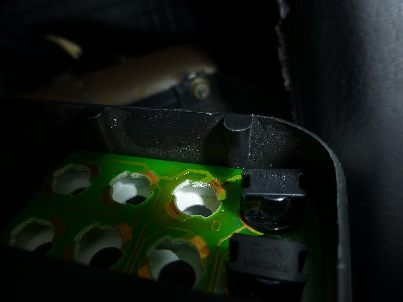

This is how you access to change any bulbs post-76861-0-03063300-1429086391_thumb.j.

They had to replace the whole instrument panel behind the steering wheel (third picture in Konrad's first post) and cost about e200. It's very easy to take out yourself though so if you had time I'd recommend trying a breaker's yard first.
