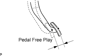

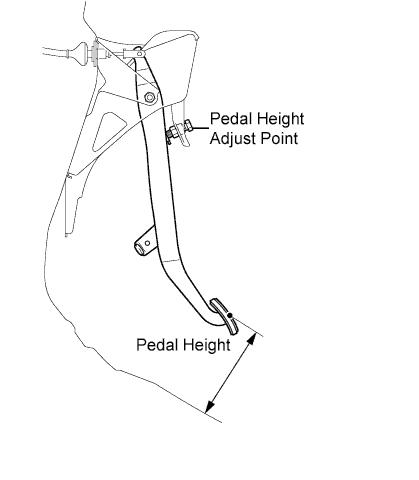

Be careful when adjusting the cable in an attempt to lower the pedal height as this can result on damage to the clutch friction plate, if the cable is too tight it pulls the friction plate onto the flywheel all the time wearing the plate out quickly. Only use the adjuster on the pedal (see picture) to adjust the pedal height. The clutch pedal must measure between 161-171mm from the carpet see picture (RHD pedal height) once adjusted ther cable needs adjusting to ensure there is 13-23mm of pedal free play before resistance can be felt on the pedal see picture (RHD free play)

Hi Devon, are you confident about the 161 to 171mm measurement? I just checked mine and I have around 120 so thought it was miles out but then saw my brake pedal to be even lower at 110mm! To set my clutch to the spec you posted would put it at least 60mm above my brake which I would find a nightmare to use (I am 6'1" and find the clutch could be lower as it is!). Unless of course my brake pedal is also miles out...
