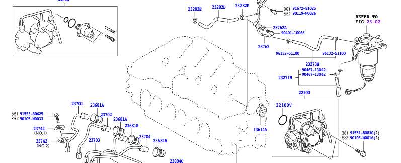

Your car does have an SCV the latest part number is 04226-26020 there is also a software update that should be applied along with the modified SCV to get the full benefit of the modified valve.
On the attached picture the servicable valve is top left part of the Pump bottom right

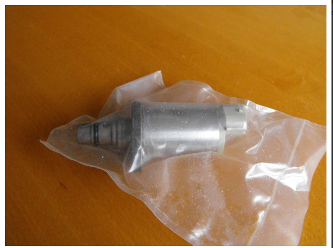

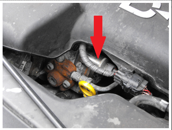

Hi Stuart and welcome to the board, nice to see a fellow countryman. I was having a look through the SCV posts but I see Devon Aygo has already answered you. No matter, i though i'd put up a picture of the valve and its location. Apparently it's held by two 5mm Allen bolts.

This one talks about HP3 sytem has one on the high pressure fuel pump fixed by two 5mm allen keys.
The pump on 03 to 06 AVE1CD engine is driven by timing belt and located drivers side front of engine below power steering pump.
post-140480-0-11725300-1448209570_thumb.
post-140480-0-40314000-1448209636_thumb.
