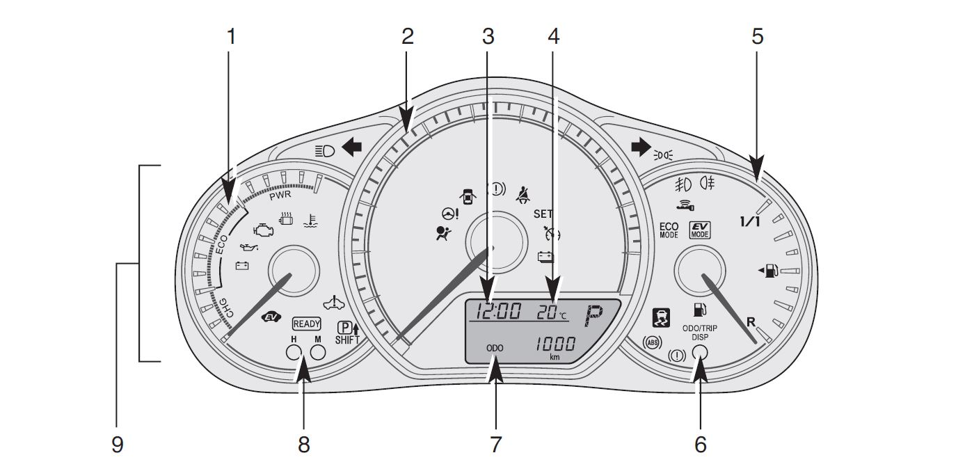

On my Yaris there isn't a dedicated TRC light or ABS light all I have is a slip indicator which is a combination of TRC EBS ABS and VSC.slip ind.jpg This function can be turned off by a button near the handbrake.

The light I'm talking about it the one Peter S has posted - Slip Indicator.
Ah my bad! Reading this on the mobile while trying to work, sometimes I have to read really fast ;)
Right so I attached it (can't be bothered to get out and get my manual or take a pic of my dash, it's Sunday morning and I am being lazy).
Although that dashboard is not exactly the same as mine (some lights are not in the same position) you have an ABS light and an anti-slip/traction control/whatever you want to call it light. On my dash, the ABS is where you see it there, while the other light is on the left side. My manual also explained the behaviour of each light, this one I found doesn't. I can't remember if it just said that the ABS light comes on when you start the car and then to signal a fault with the system, rather than coming on when it's operating (like the traction control one does). It's inconsequential at this point :)
