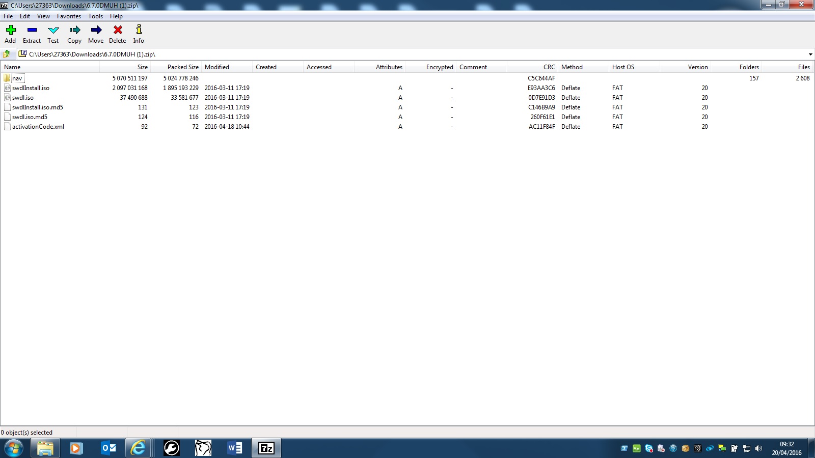

I fomated usb stick to fat 32 and un zipped the file to the usb please see below what you should have on your usb stick.

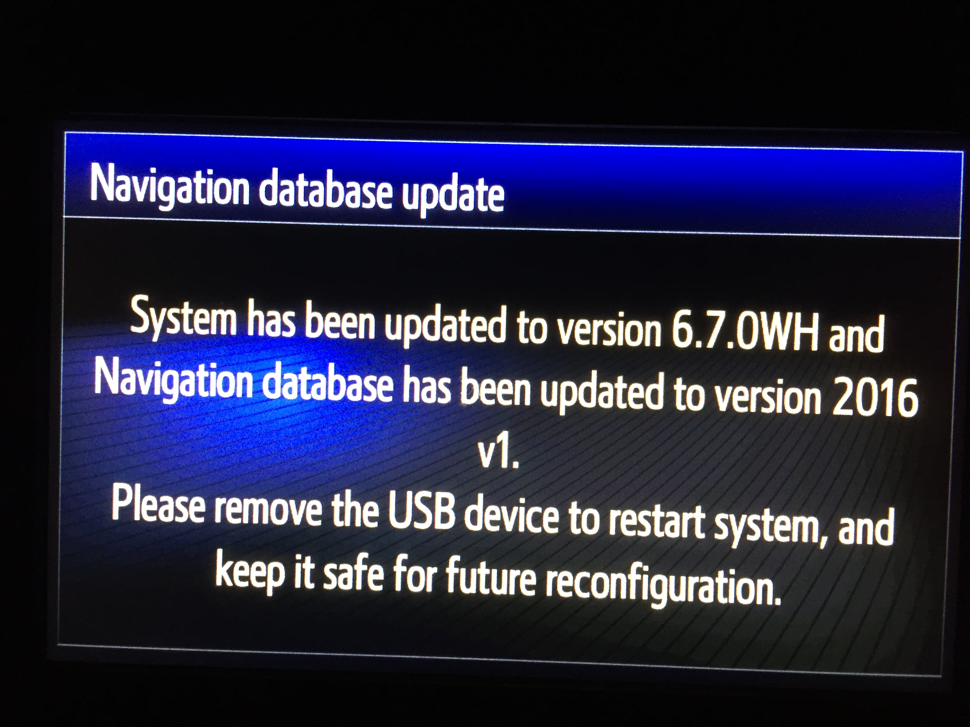

turned on car waited 2 mins for the car to settle down the inseted the stick. two grey folders poped up then it sarted and i had to put in code.
only insalled GB map and it took about 30 mins to complete.
I've got all the same files on my usb I had the two grey folders pop up but nothing happens. Did you take the files out of the folder?

Hi
if you open the usb stick the photo above is what you would see.
I know it take a couple of hours but I would download again.
remove any usb sticks from your car before you turn on and try again.

All sorted finally got it installed,I went out and bought a new usb did the job.

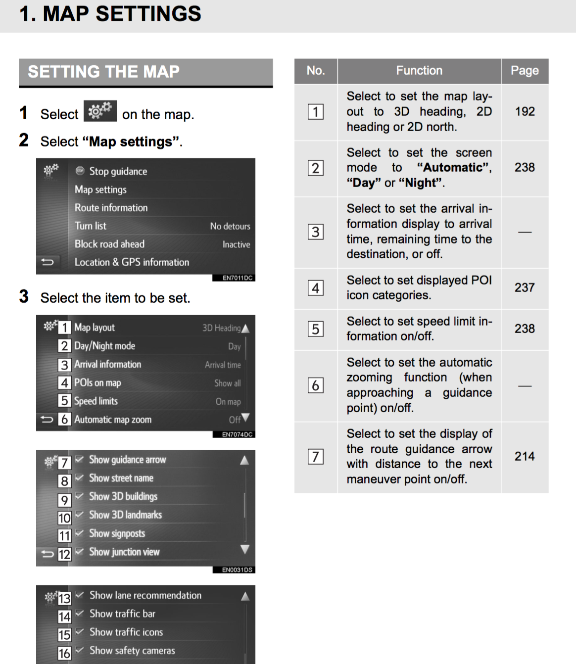

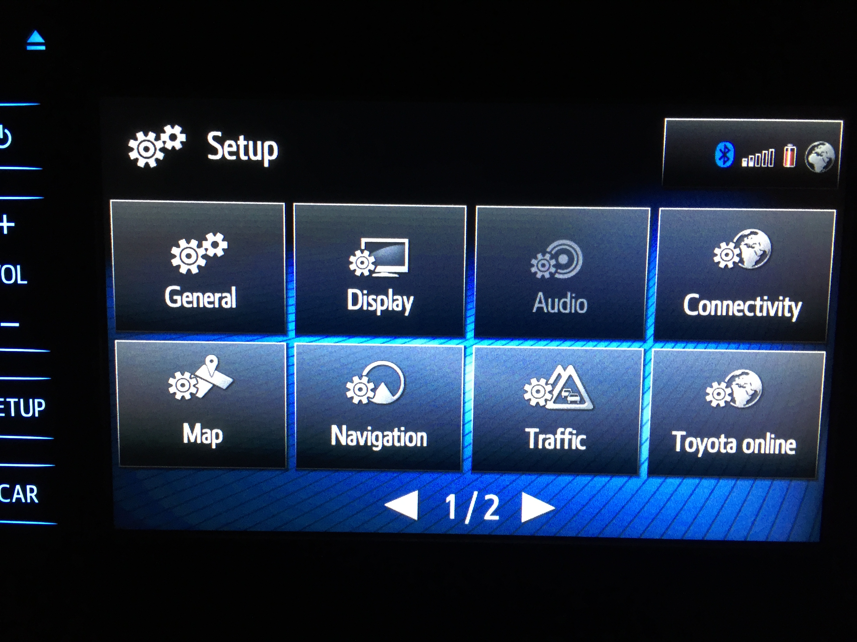

We have just got our Auris Tourer  (2016) back from Toyota after a rear-end repair, and whilst trying to sort out the the rubbish DAB that we had they updated the software. I don't like the new software as yet, but it's not been 24 hours; some things are harder to find, some a lot easier. As they have updated it for us I presume the full maps won't be on? Will we be able to just d/l again onto the usb and install them that way?
Also, we can't for the life of us find the setting for the beep warning about safety cameras. Have they removed this as a sop to the French, or are we both being blind? We've even tried to find it via the settings in front of the driver.
As far as I know you can only turn the safety cameras on or off, the sound of the beep only increases as you turn the radio/ CD volume up, at least there is now a countdown marker to the camera now.
regards
We don't have a beep at all, that's the problem, and nowhere to turn them on or off. This is on the latest software  6.7.0wh
Ah, OK. Well its not a double beep anymore, its single and very quiet. You can turn them off/ on I think its under the POI settings?
regards
Nope, not there either :(
This is from the manual before the update, if i remember correctly, its not changed but if it has, not that much so you should still be able to find it.
regards

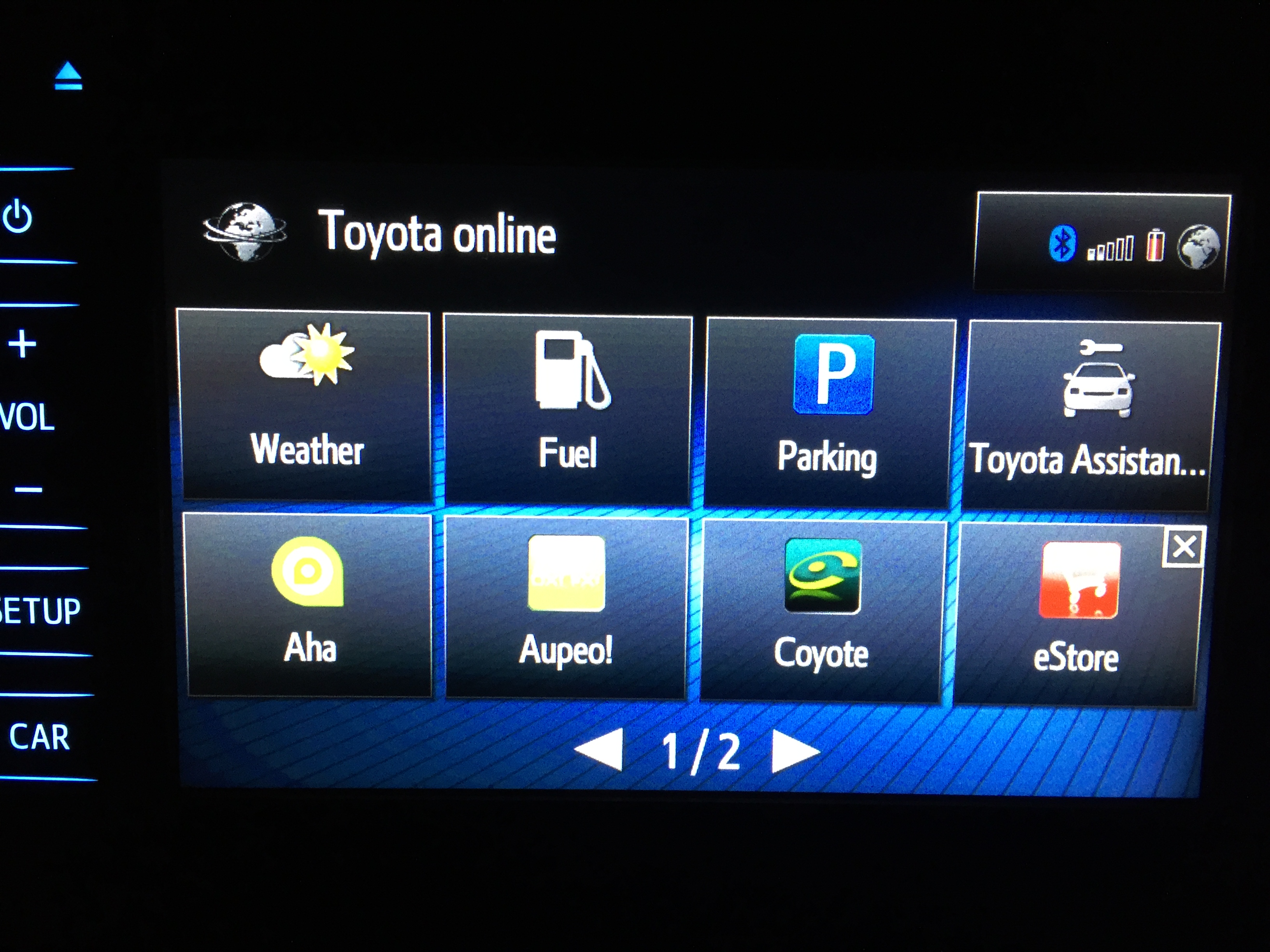

just bought the latest update for touch 2 with go but can find nowhere for download op. checked purchases which gives a list of what you get which also shows installation instructions to be done via bluetooth via estore ap in car? does not work. thought it was done to usb vvia computer. can anyone advise. thanks
If I am reading this right.
Sign into my Toyota. Go to e-Store purchases, click on the map update you purchased (mine shows 6.7.0HMap Update 6.7.0H, then click on download to USB, don't forget to print/ copy the activation code.
regards
Thanks ic2 found download now and installed. Seemed to be intermittent on website contacted toyota they said update password and it worked. How did you do with other one, estore update, can't get it to work. Unzipped file gives you a jar.! Put on flash but nothing. File does not extract or open. Using vista. Downloaded 7-zip to try but that doesn't work either. Will buy new flash see if that works. Btw Toyota instructions for nav download said use8gb flash but had tu use 16gb as message came up capacity too small. You same?
I tend to update any apps from the e-store (i don't really use any apart from fuel and parking) direct from the touch screen, i find it easier. I agree on the USB size, i used a 16GB and it was fine, 8GB caused me a few issues as well.
