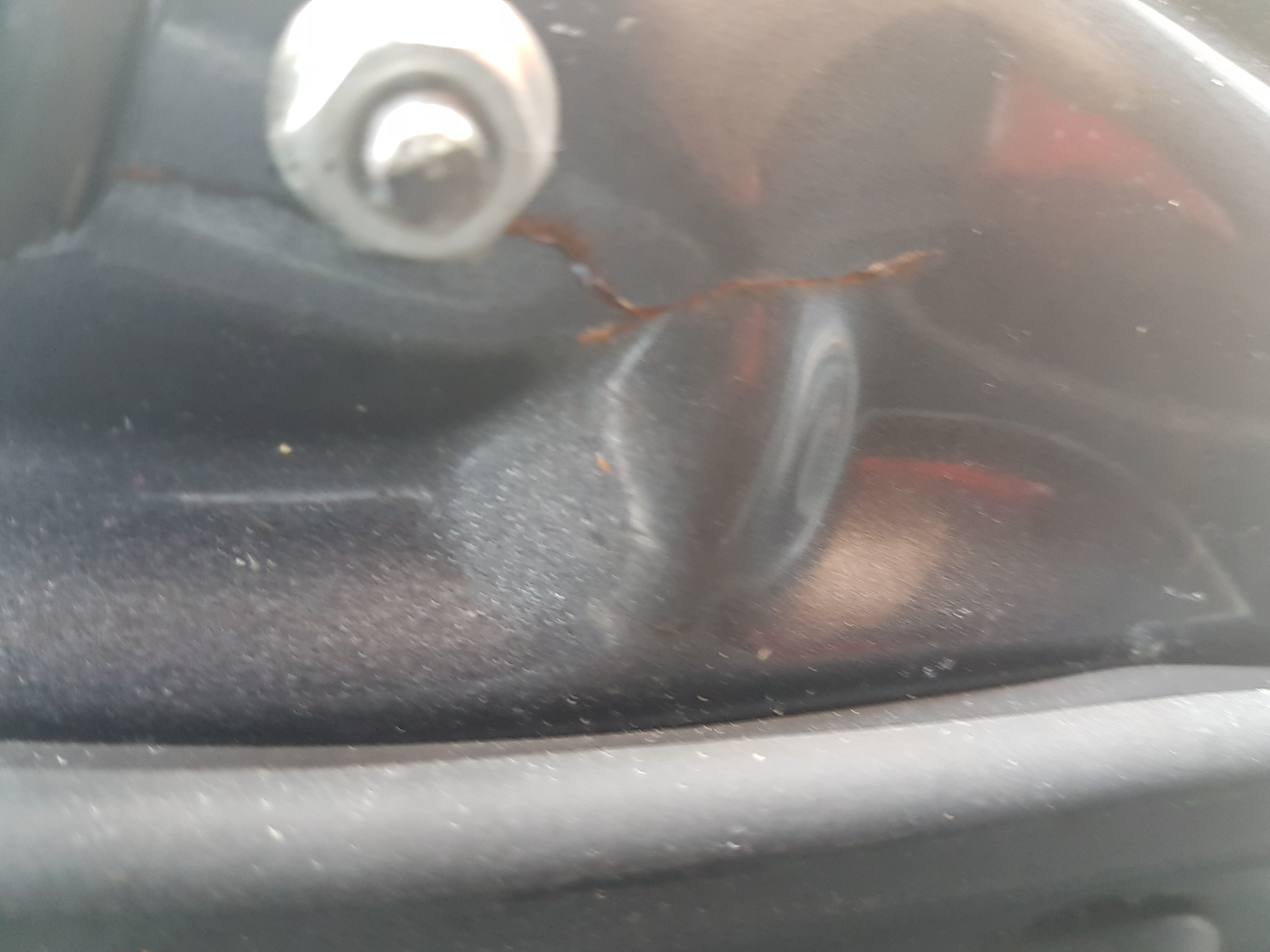

Purchased my car over a week ago and I have had a few problems with it already which the dealer is going to investigate next week.
Another problem im having which I failed to mention to them, is there is a lot of wind noise coming from the drivers door when driving at motorway speeds, also when I close the drivers door its sounds different than the passenger door almost like a van door closing.
Any suggestions on what might be causing this and how to resolve would be great.

you might want to check if there are any cracks in the door by the restraining straps - it's known to have happened in a few. Check door seals, they are 7 years old after all & check hinge adjustment.

Spot on heidfirst. I presume this is whats causing the excessive wind and metal flexing sound when I close the door.
Should this be covered under warrenty from Toyota considering I only bought the car last week? Or did they do a recall?

All sorted got a new door under warrenty and also new seals around the small window beside the wong mirror as the seals had deteriorated and was the cause of the wind noise.
