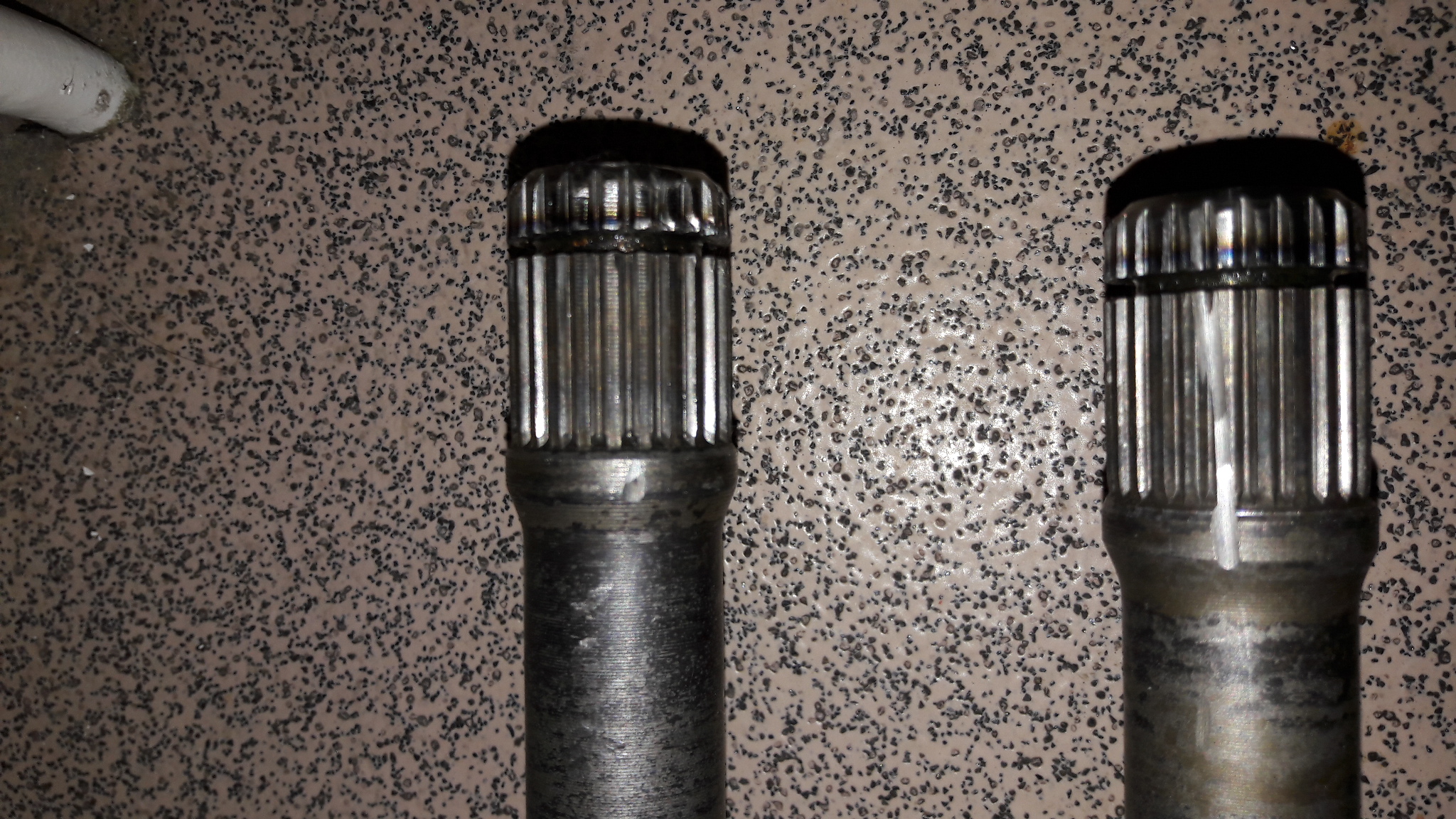

I misjudged the depth on one of the shafts and grinded of part of a teeth, see pic, hope its not catastrophic. also I could see the affect of all the hammering on the tip on left, it flared up where the snap ring was pushing looks shorter.
Anyways its done, its got 24 teeth, I picked up 2 from GSF for £65.xx, these are made by GSP, ones from Amazon were 23 they are going back along with tools.
See what you mean about the tip flaring up, think you will need to file/grind those down or doubt it will slide into the new joint.

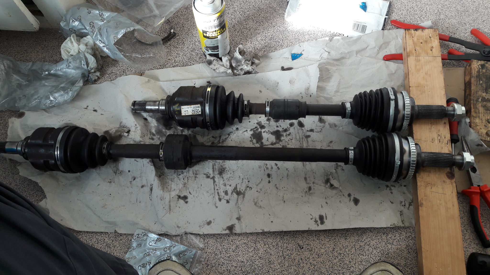

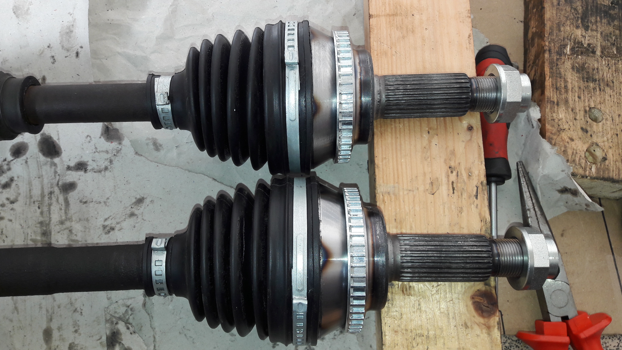

All done ready to go in tomorrow after work.
Advice to anyone who wants to do this is to cut off the old joints and not even think about hammering, it just wont budge. Thanks to Bempa for high lighting that.
I flared the end of the spline by hammering thinking its going to come out. I had to tap it gently to get rid of tge ridges and when insert the new joint it took a lot more hammering than the one I didnt touch.

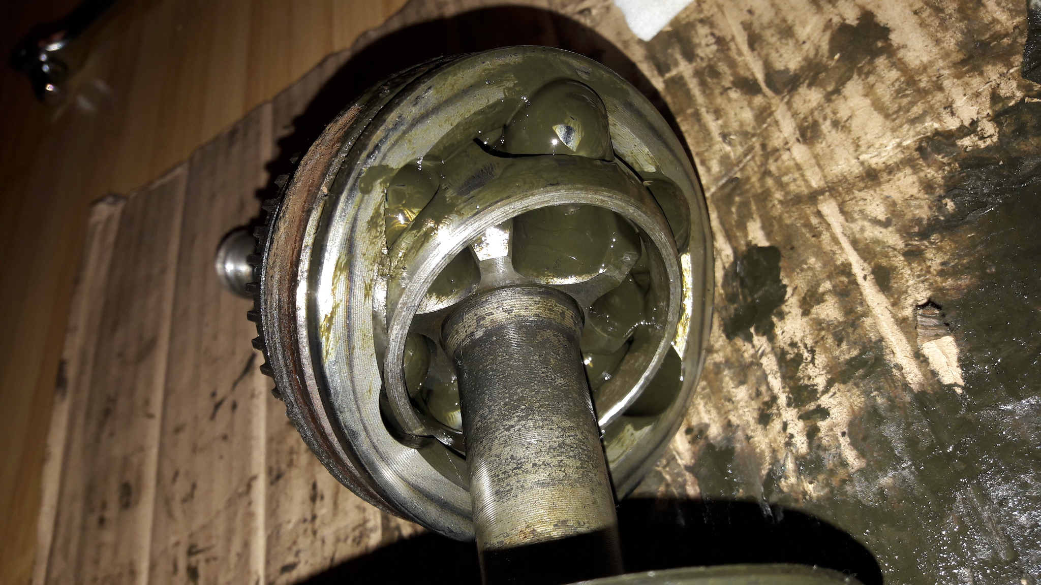

Another thing I noticed was the passenger side inner joint (one tgat did not split during removal) bearing was loose in the cup, when I removed the boot it came of the shaft, the snap ring was in there too. Either it wasn't put on properly or somehow it came off.

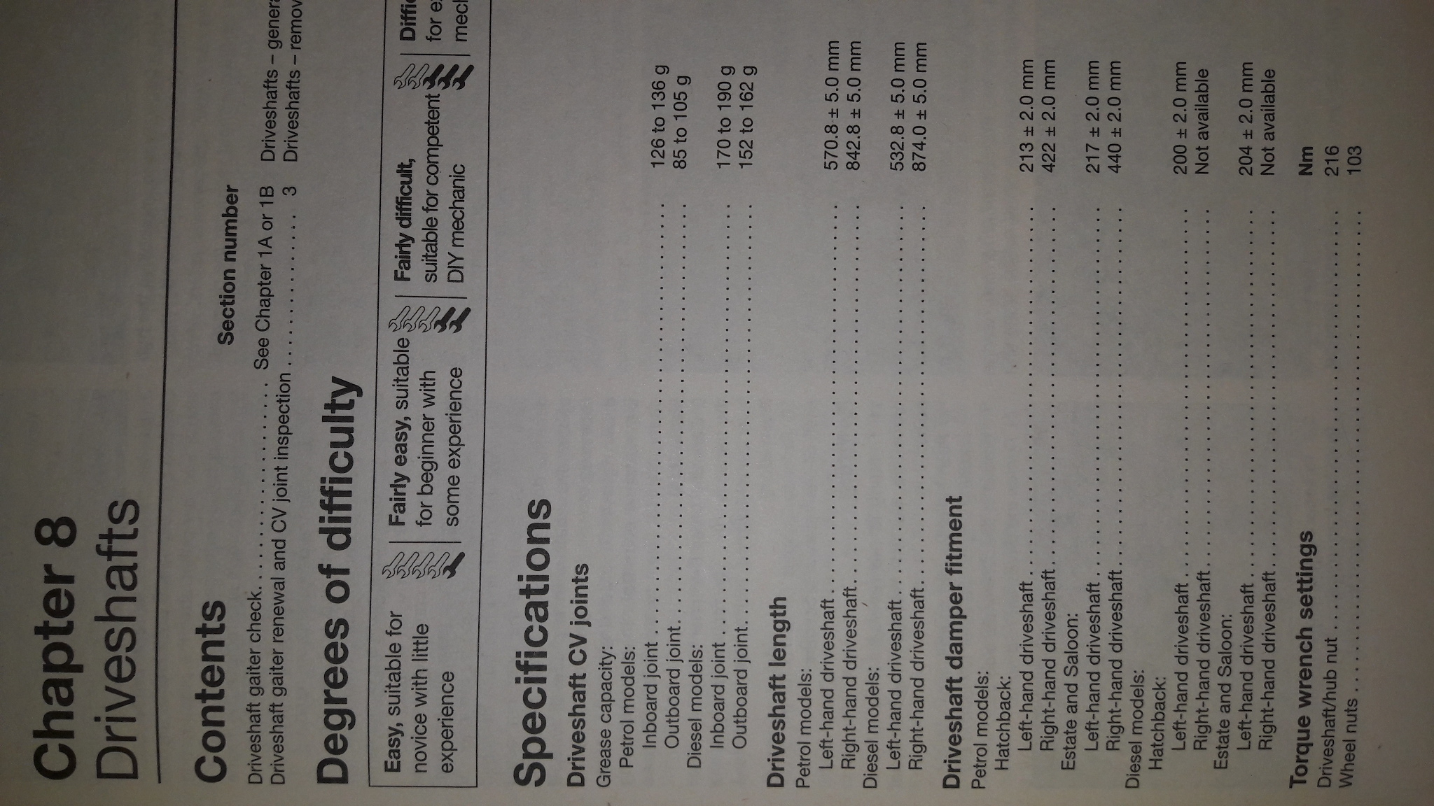

Missed some info as I didnt have this haynes with me at the time. I didnt know about setting the length of the driveshaft before tightening the cv clamp....hopefully all ok as car drives fine.
Also was a but short on the amount of grease in the Inner joint, I measured 110g in a food bag and most of it went in little waste so. The outer joint was ok 90g came with the new cv joint.
